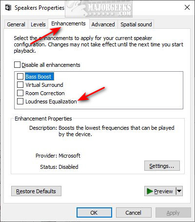

This is a popular problem… close it FXSound and activate Loudness Equalization in Windows
