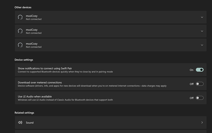

Disabling LE solved a connection problem for me.
Settings > Bluetooth & Devices > Devices > (scroll down) Device Settings
does not appear in my settings. Here is what I see.
