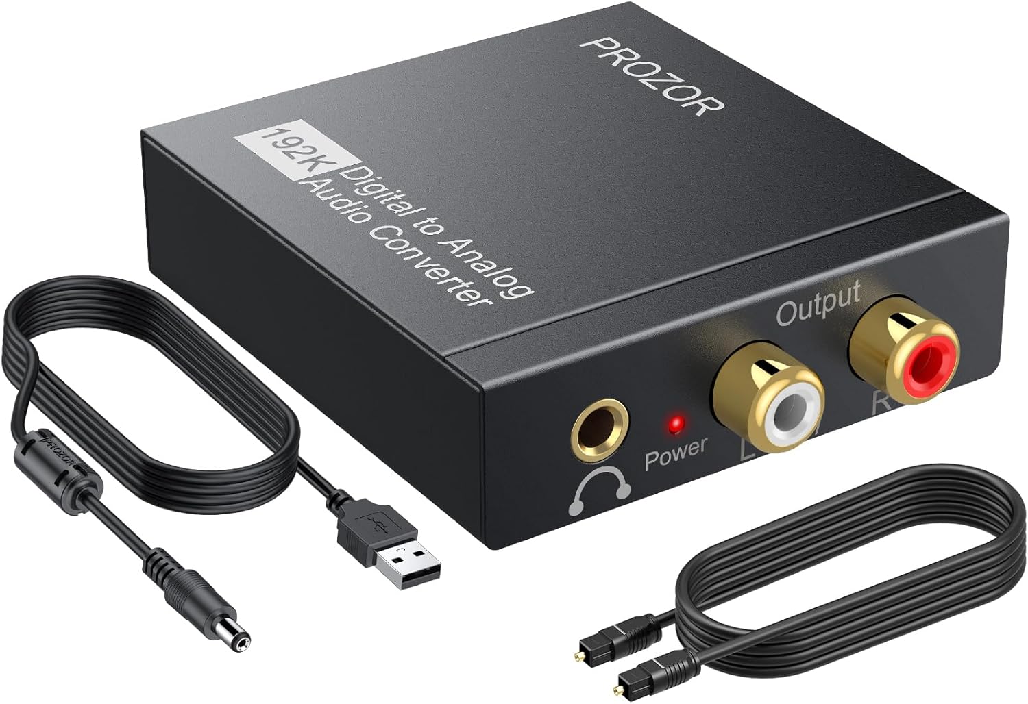

I have a USB-to-toslink (SPDIF optical) adapter, which goes to audio devices

Then please define “USB SPDIF Adapter”. You are describing what happens when the power supply fails. This is a physical action and it does connect and disconnect the device attached to it.

that item is not a USB SPDIF adaptor - it is a Digital to Analog Converter. A USB SPDIF adaptor converts the output from the USB port, to an optical toslink signal, to be used with optical speaker devices. (there is no analogue component to a USB-to-optical converter)
It’s highly unlikely that the USB power supply for a DAC would fail – the power supply for the DAC is a USB-style input, taken from a mains powered USB port (the quality of mains USB adaptors can be questioned- but is as reliable as the next hardware, and hasn’t changed in FXsound version changes)

Your DAC cost more than $10, my bad. Test with any available. All power supplies will fail. No exception. “Spend more” assumes you do not have one handy.,
The reported problem point for point matches a failed power supply. That does not limit the cause to the power supply but one test is cheaper and faster than the next.
It isn’t a DAC, it’s a USB-to-optical (Toslink) converter. The power supply to the above linked DAC is a USB input, which can either come from the laptop itself (not recommended) a USB hub (reasonable) or a mains usb socket output (I’m using)
Spend more makes no sense if that isn’t the problem or the solution. As you can see from my previous descriptions, the power supply is not the issue (the power supply to the USB-to-optical converter comes from the USB connector itself)
Side issue but I do in fact already have exactly the DAC described in the link (by chance) – but that accessory is no where in my current system setup
