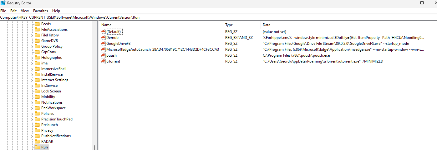

I wrote about it on github, do you have ‘FxSound’ key in registry at
HKEY_CURRENT_USER\Software\Microsoft\Windows\CurrentVersion\Run ?
